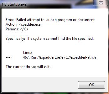

I'm getting tired of the command prompt window that briefly interrupts my cabinet's boot sequence. This should do the trick! Thanks!
MOTUMAME: The Masters of the Universe Multiple Arcade Machine Emulator!
Posted (edited)
I do not use xpadder so I replaced it to joytokey (Keymapper=joytokey) but I still get this error:

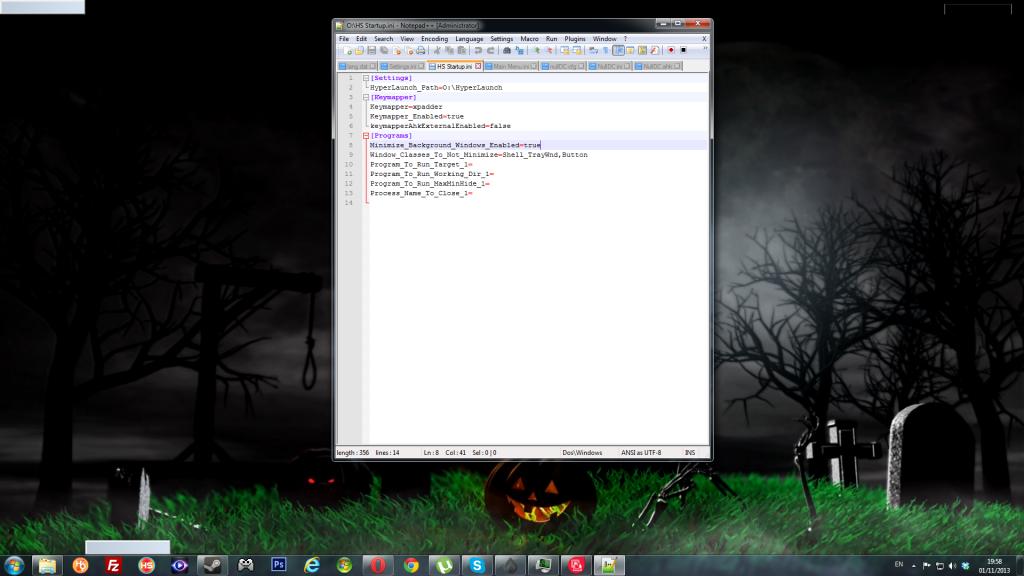

This is my empty desktop after exiting HS, all that is left are those grey rectangles. Icons are gone and so is the cpu meter.
I wanted to use your tool to minimise any windows I forget to minimise when I start HS, as occasionally when I exit a game,
1 or more of those windows may be over the top of HS.
The only way I know to return things to normal is to reboot. Sometimes the show desktop button will bring icons back.
Thanks for any input.

@bb_neo, I fixed the bug you found, thanks for reporting it.
@gigapig, some windows don't like to be minimized so when they are forced to minimize they leave those boxes. Use the Window Spy utility that comes with the autohotkey or autoit downloads to get the class name. Just append the class name of that window to the list in the ini of the window class names not to minimize.

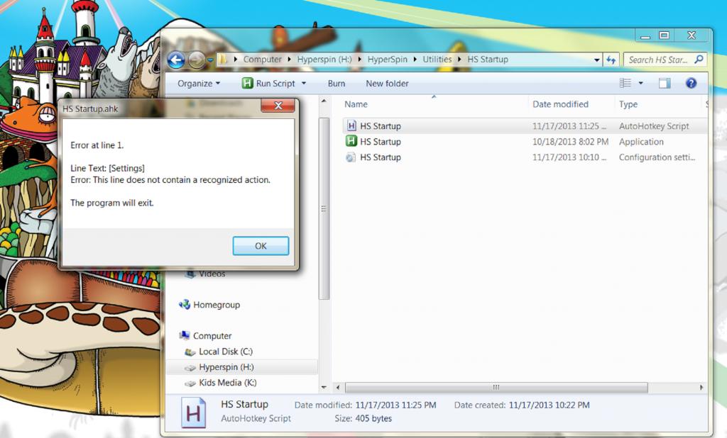

Hey ghutch when I run this script I get an error saying: Error at line 1, line text [settings] error this line does not contain an recognized action. I followed your guide and the only thing I changed was C:\ to H:\ since H is where hyperspin is.
Posted (edited)
screenshot?

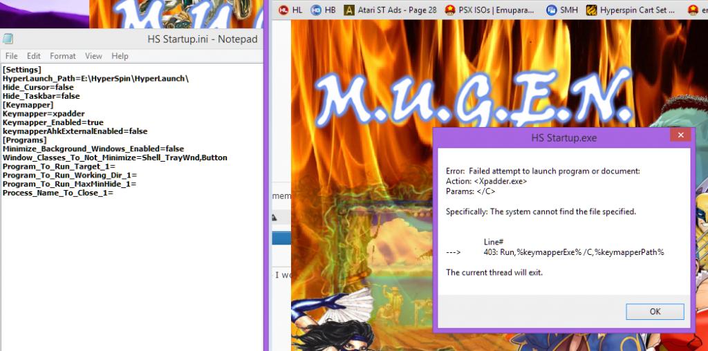

Posted (edited)
[ATTACH=CONFIG]34931[/ATTACH]
I see a user error, not a program error. You can't just go around changing file extensions to ahk and expect it to work. Nowhere in the instructions did I tell you to change your ini file's extension to ahk.
If you want to write an ahk file read the autohotkey documentation.
Edited by ghutch92
Posted (edited)
I see thought that was what needed to be done sorry for the inconvenience. Thanks for the help non the less.

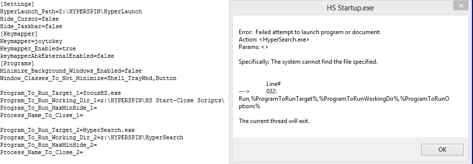

I have tried to add the new HyperSearch tool to your HS Startup script but I get this below. HyperSearch starts fine when launching his exe. I have double checked the paths.
Can you test to add this on your side please?
I tested with and without the "\" and end of the line but same error.
Program_To_Run_Working_Dir_2=z:\HYPERSPIN\HyperSearch\

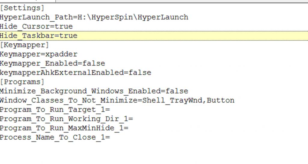

Posted (edited)
Ghutch,
[ATTACH=CONFIG]39923[/ATTACH]
Tested and no issue, maybe you are looking at the wrong setting?
EDIT: My bad, it's fixed on my end but I just tested the one I had in the download link and it seems to be the older v1.02 I just updated it.
Edited by ghutch92
Thanks for the update. Confirm working with my settings above. However, if you set HyperSearch to be Target_1 the script tried to open 2 processes of HyperSearch.

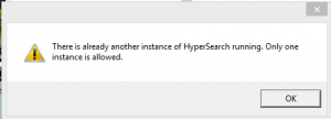

I get this:

That warning comes from HyperSearch and not the Startup Script.
